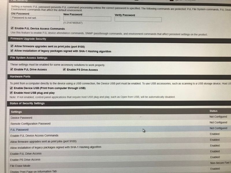

Thanks for your help, I chekced and it was enable, however I disabled and enabled it and seems error of usb did not come
But unfortunately, I have same error of 61.00.00 ,

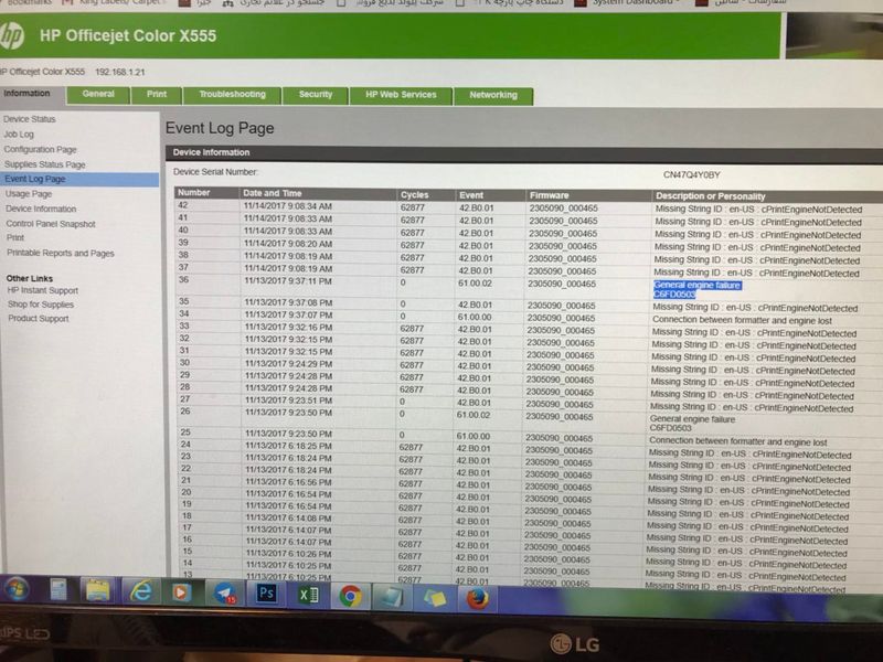

pls see this picture also as :
this is error I wanted to show you also, as you mentioned to me it's interconnection board problem so could help me
how I can solve this problem . believe it I set aside time by more than 1 month and can't fix it, I hope you can help me,

From the event log you have posted, I can see the 61.00.02 error in more details (C6FD0503). This error relates to "Printbar malfunction" and the action suggested by the HP error code manual is to "Replace engine with Mech Kit".
 Recommended action
1. Turn the power off then on by pressing the power button and holding it in for more than 3 seconds.
2. Turn the power back on using the power button.
3. Repeat steps 1 & 2 again if the error remains, then:
1. Check the installed firmware version and update the product firmware as needed.
Even with the printer on error condition you can still navigate the menus and FW version
2. Turn the power off and remove the formatter, check the formatter thoroughly for any loose connections and reseat them, then reinstall the formatter.
4. If the error persists, replace the Mech Kit.
5. If the error persists, turn the power off and remove the formatter, check the formatter thoroughly for any loose connections and reseat them, then reinstall the formatter.
6. If the error persists, replace the Mech Kit.
7. IMPORTANT: Print the event log OR access the event log through the EWS. Under the Description or Personality field, look for the 8 character fail code values corresponding to any 61.00.0X errors and log them into the case notes. These values are critical in helping the division understand the failure and in debugging potential field issues.
I am not very familiar with officejet (inkjet) models, so maybe someone else can tell you what to do next or what the Mech Kit involves.
