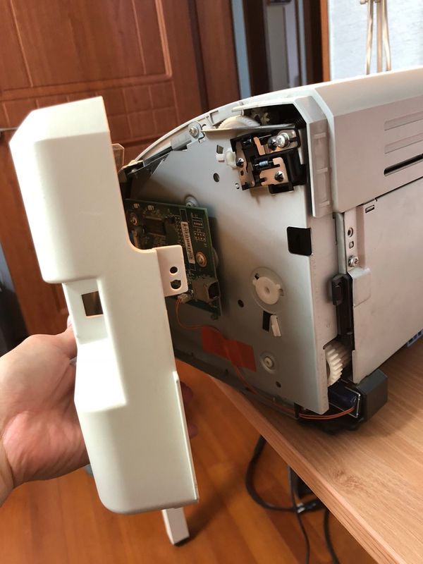

The solenoid is an electric magnet found on the side of the printer. HP stuck a bit of padding material in between the metal plates of the solenoid so it doesn't make noise when printing. But over time the padding material wears out and turns into a sticky residue and causes the metal plate to stick for milliseconds too long (triggering the printer to subsequently pick up an unneccessary extra page, resulting in jams). Just remove the residue with a QTip or cover the sticky residue with a little scotch tape and the solenoid is back to functioning properly! No need to mess with the spring and risk breaking it off.
Laserjet 1020's sideLaserjet 1020's sideYou just need to undo this one screw on the back to take the side cover off.You just need to undo this one screw on the back to take the side cover off.Fiddle and pop off the side cover.Fiddle and pop off the side cover.This is what the interior looks like.This is what the interior looks like.This is the solenoid (an electric magnet). The black screw on top of it is the only screw you'll need to undo to take the solenoid out.This is the solenoid (an electric magnet). The black screw on top of it is the only screw you'll need to undo to take the solenoid out.I'm using a screwdriver to show the metal plate being held down (which is what it'll look like when the electric magnet is engaged.I'm using a screwdriver to show the metal plate being held down (which is what it'll look like when the electric magnet is engaged.This is when the magnet isn't engaged. The solution is to remove the solenoid and take a qtip and wipe off the sticky adhesive residue until the metal plate no longer sticks. The sticking is what causes the printer to feed an unnecessary subsequent page, causing jams. You can also just cover the residue with scotch tape and it does the trick!This is when the magnet isn't engaged. The solution is to remove the solenoid and take a qtip and wipe off the sticky adhesive residue until the metal plate no longer sticks. The sticking is what causes the printer to feed an unnecessary subsequent page, causing jams. You can also just cover the residue with scotch tape and it does the trick!
