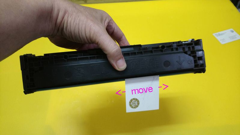

03-27-2019 02:37 AM
There's a garbage bin in the toner carbridge when it is full you will get color streaks on the page.
Try to clear it off with a business card and garbage can to collect the toner powerder.
If it acks the same after your clearing then you may have a bad magenta tonertridge needed to be replaced or if it's in warranty send it back for replacement.
Hope it helps.
