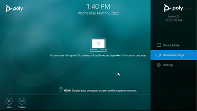

I would get this confirmed by our official support organisation but testing this with a Poly Studio X 50 running 3.10.0 with a G7500 paired Bluetooth remote pressing the 3 vertical lines will bring up the side menu:
Using the navigation bar in the middle to the right and down to select Camera Settings will bring up the next menu:

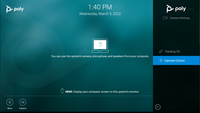

In there you could turn off or on the camera Tracking or use the camera control if tracking is off to use the + and minus to Zoom in and out and the navigation pad to have the other actions
