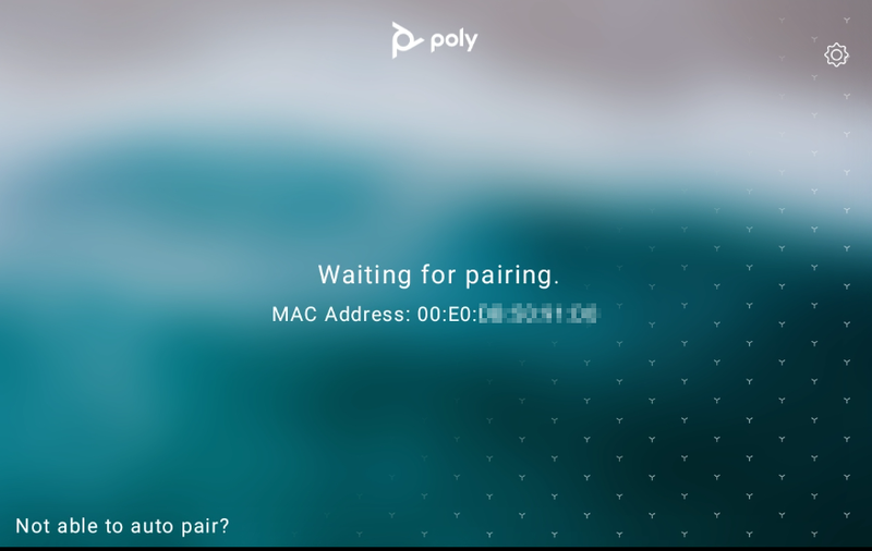

I am currently having an issue where the bar crashes every time it goes in to standby/sleep and the only way to get it back up and running is to unplug it and plug it back in. I'm running a few tests this week i.e factory reset, testing in device mode, testing in Teams to try and work out if the issue lies with teams or if the issue is with the device itself.
The device has been factory reset and is on the latest version.
It run fine for the last 2 days, however when I came in this morning the controller couldn’t detect the Poly X70, had to unplug and plug the X70 back on to get the room operational.
Can anyone advise?

just a follow-up, when you state it cannot find the controller. What UI on the Touch controller do you see:
or
or on a Microsoft level
Best Regards
Steffen Baier
Hi Steffan,
This is the image that shows
Kind Regards,
