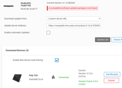

If my endpoint is on 4 and my TC8 is on 3.12, I don't see a way to update the TC8 to 3.14 before updating it to 4. I have bricked a few TC8s this way.
Anyone know a process for updating just the TC8?

if the Studio X or G7500 device is already on PolyOS 4.0.0 use the custom URL:
Then verify the TC8 is running 4.0.0-210881
Then you can AUTO Upgrade for both again

Thank you for the URL. I did see that, but when the custom URL is used, this is what I get:
Hello @Andrew_DeBoer ,
welcome to the HP Poly community. I would have hoped you could just upgrade the TC8. In this case, I suggest you contact our Support organization in your region. Details are in my Signature.
