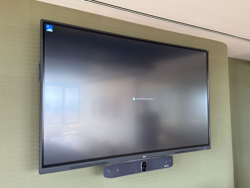

I have the same issue. The Poly X70 is running the lasted version avaiable. But the costumer must disconnect the USB touchscreen cable to boot the system.

HI,
The system is running in MS teams mode.
The system is making auto updates from poly web servers.
I can get more detail about the system on Monday.
