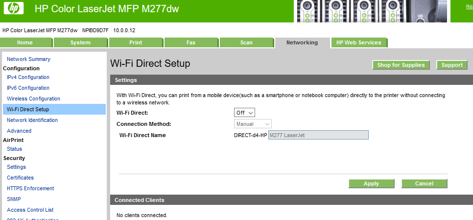

No soution yet. Exact Same issue here.
Went to Web interface. Wifi direct is clearly off.
Wifi direct off
But the Printer continues to broadcast:
HP-Setup>d4-M277 Laserjet
It is an unsecured broadcast signal. I am unable to obtain an ip adress through this broadcast signal. While I am not a hacker this seems a pretty basic security problem.
Any other suggestions? Giving you a kudo for trying, though.
