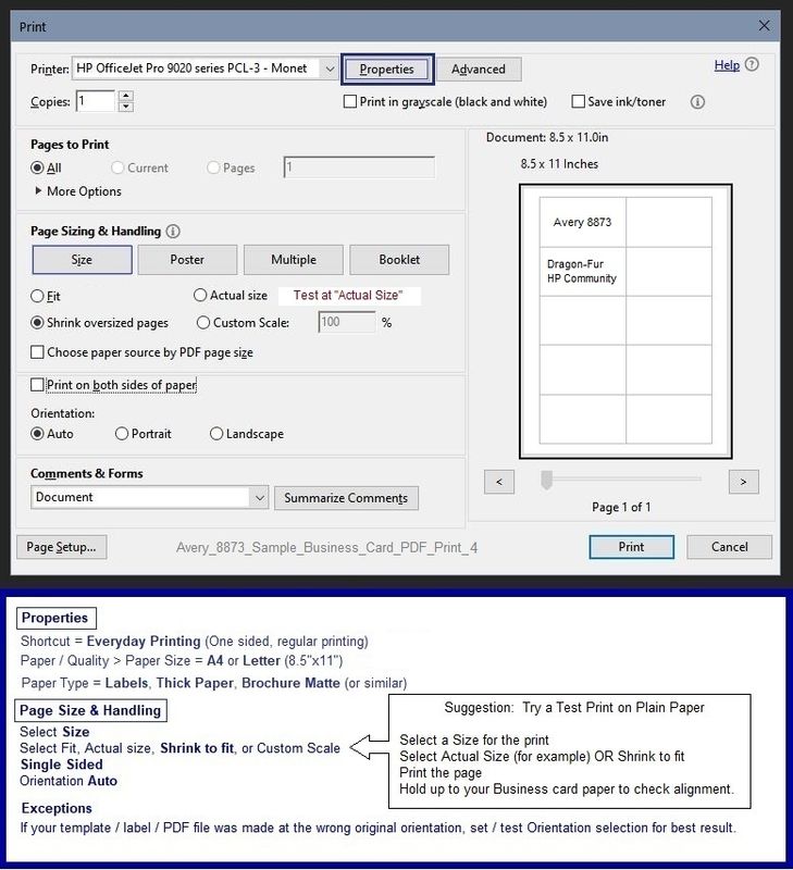

Set your paper size to "Letter" 8.5 x 11 inches
Set your paper type to Brochure, Card, "Thick" or similar (not Photo paper - printer can tell the difference)
Example - Avery 8873 Sample Business Card - PDF Print - Windows Adobe Reader DC
Note - The template in the example is different - setup is similar / same
Avery_8873_Sample_Business_Card_PDF_Print_4

Example - Retain / Modify / Check Paper Size/Type - Tray and Paper Management
Retain_Printing_Preferences_9
