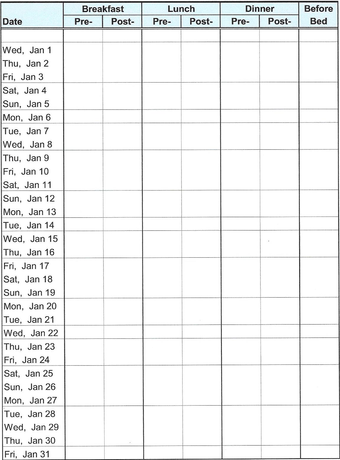

I have inserted the scan here...there should be grid lines for every line but as you can see, some are missing.
@Badger66
Check the warranty ends date on the cartridge. If it's in warranty I'd suggest contacting HP Phone Support for a replacement. Can you please let me know how you get on?

Today I replaced the Black ink cartridge in my new HP Envy 5530 printer.  The expiration date on the old cartridge was OK (July, 2015) as was the date on the new one.  I printed several Excel files in the hopes that a faulty ink cartridge was the problem.  No such luck.  All three speadsheets had missing horizontal grid lines.
What explanations are left?
1.  Faulty printer.
2.  Bug in the printing software.
3.  Bug in Excel (that was not apparent with my HP Officejet 6300).
4.  Subtle glitch in the internet.
5.  Other??
Your thoughts.
