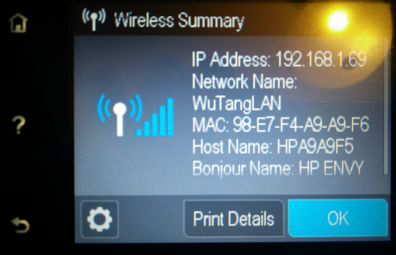

I have also taken a photo of the screen on the printer to show that it is connected to my network:

Do you know what is the IP address of your router. It should be 192.168.1.0 or 192.168.1.1.
Regards.
BH
It says 192.168.1.254
