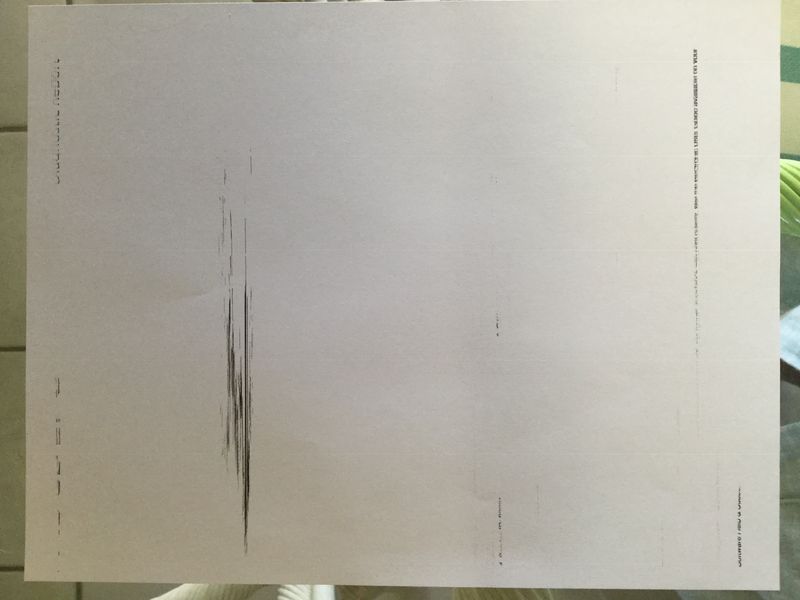

Hi, Riddle.  I am so new to this.  Thank you for replying.  I did what you said.  It printed and all that was there were some black, bold lines in the middle of the paper.  Here’s what printed.   I cleaned the printer heads with alcohol.  I watched a video and did what ‘Brandon’ instructed.  I didnt take printerhead out.  Just cleaned where ink goes in and let it dry overnight.  I tried new black ink even so it is that.   Is it hopeless?  I’m willing to try any procedure since right now the printer is useless.  Thank you SO much! What prints.What prints.
@Vtopmiller To confirm, the copier works the same as your printer? if yes, here are a few things I suggest you do:
(To try everything possible before we can conclude it's a hardware malfunction)
