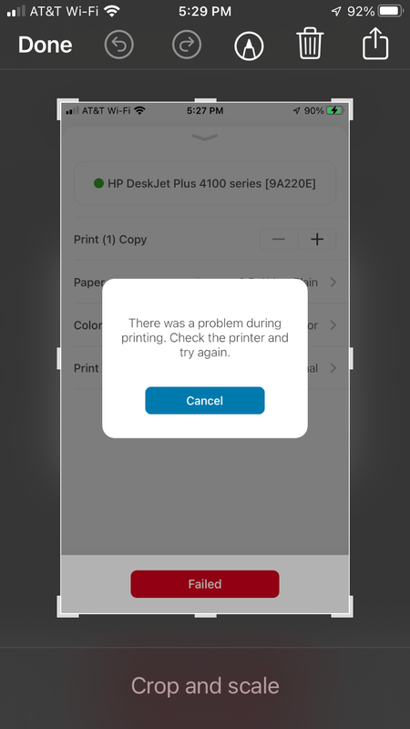

  • Do you get any error messages on the iPhone? Yes. When using HP Smart to print, it sees the correct printer and then fails to print. I can scan from my iPhone but cannot print. This is very perplexing. The error message is error while printing. I get the option to reprint and same message again.
The firmware is correct. I do get a message that the app is seeing more than one router with the same wifi name but I only have one router which supports the typical two bandwidths, 2.4/5. I'll try the power drain and Airprint solutions and get back to you. Thanks.
This is the error message I get printing with HP Smart
