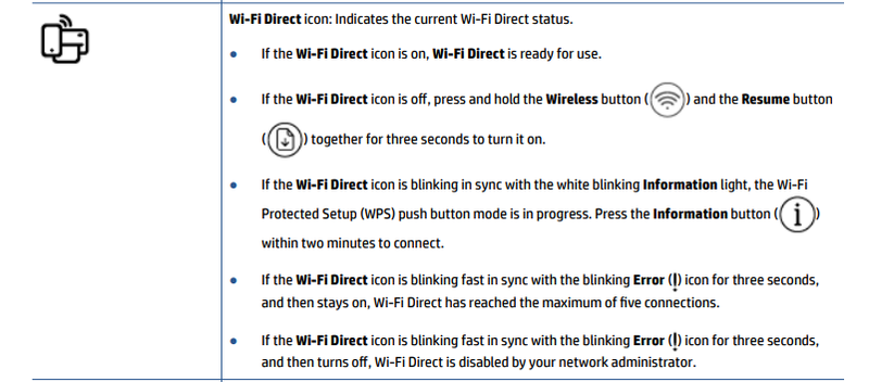

> Turn on the WiFi direct feature on your printer. (Refer to attached screenshot)

> Connect to the network using the password. Default password is '12345678'. If this does not work, you can print the information page which would contain the password. (Refer to attached screenshot)
