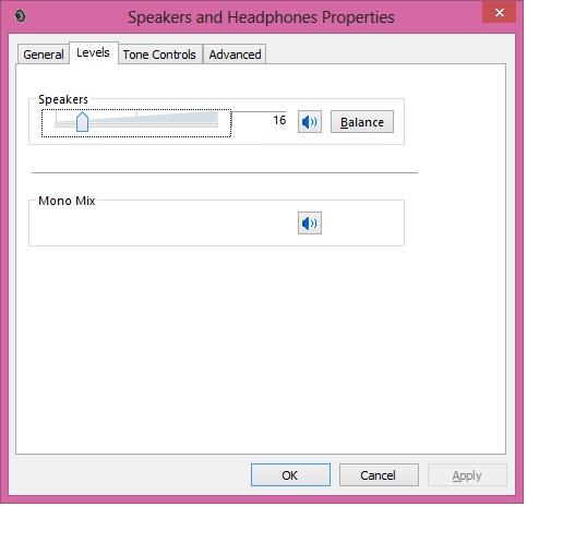

Thank you for your feedback! I really want to try to help resolve this issue because, even though I haven't experienced it personally, it seems like it would be annoying.
I'm inserting a screenshot of what I see on the Levels tab of the Speakers Properties window. Would you mind replying with a screenshot of your Levels tab?

I have changed the low and critical battery levels and notifications in advanced power options. Before i performed the BIOS update, I was only able to get the ciritcal battery level down to 7% and the low battery level to 8%, after the BIOS update I was able to change them to 2% and 3% respectively, I also have my low battery notification set to off, but as I said in my first post, all this does is stop the little window from popping up that tells me my battery is getting low, it does nothing to stop the beep. The beep still starts as soon as I get to 12%, and it is one of the worst sounds I've heard a computer make, it is also very loud. Muting the speaker volume dulls it down quite a bit, but there is still a beep coming from somewhere else. I have to go into the levels tab and also mute the mono mix level that you see above. That gets rid of it completely but you obviously don't want it muted all the time so you have to wait til the beeping starts. If you aren't expecting it and the room is fairly quiet, it can scare the sh*t out of you. It seems like a very minor problem, and I suppose it is, but if you're out in public and you forget to mute everything it can be quite embarrassing, and it's not fun when it scares you either. I am really thinking there isn't a solution at the moment.

Like Ashleyef, I do not have a PC Beep volume option in my mixer. It's strange, but it appears that muting the speakers and the mono mix (not just one) does stop the beep. I've also tried disabling the speaker/headphones completely (via right click in the playback device menu) with no success. How would muting the speaker work, but disabling it not?
