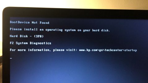

HI guys,
the HD is ok but when i put it in to the probook I get 3F0 error 😞
This happen maybe due laptop firmware update, because before, the HD worked fine on the seam PC .
Any idea ?

Hello,
the message at boot time is below :
the F2 diagnostic dosent find the HD both with short and lonf test
But for sure the HD is OK.
All test on the target HD was fine and it's a clone that I made of a working HD.

When I replace the HD in the HP with the suspected one and change the bios to legacy (but I have the same result with UEFI)
I have again "Boot Device not found" and (3F0) error and below the result of F2 short test  😞
