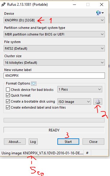

now you ask about pen drives, USB flash memory sticks, it ok but is tricky too.
ever use RUFUS?, and burn a stick using the dual mode, with safe boot off?
you must format a pen drive properly or it will not boot in UEFI systems.
this stick below work, on all my PC,s regardless. if HP or homemade with W10 from scratch.
test,2
