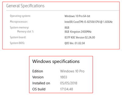

This is the version of windows that I am on.

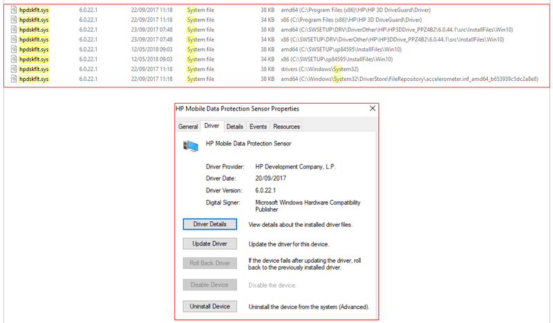

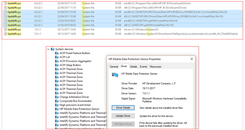

Scanning my PC for the offending hpdksflt.sys reveals these instances:
The ones highlighted in blue seem to be the ones that HP is recommending.. as I am prompted to download those into SWSETUP\sp84595.  However as you can see at the bottom Windows has helpfully decided to roll with newer versions.
Checking the device driver reveals the same - that Windows is using 7.0.1.1:
