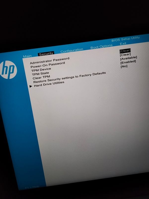

hello @NonSequitur777 and thanks for the reply. yes i can confirm that the tpm is activated here is also a picture of the tpm settings. i am using the laptop already about a good year with windows 11. IMG20231015073854.jpgIMG20231015073854.jpgthe upgrade was not a problem. i never had any problems with tpm before. it started when i was doing the latest bios update. the notification came up while it was doing the bios update and when i was acctually expecting the bios update to be completed and to see my login screen i saw this notification instead.

@lio123,
I noticed that your TPM status was "Available", is there an "Active" option?
[EDIT:] Never mind: "TPM State" is "Enabled".
