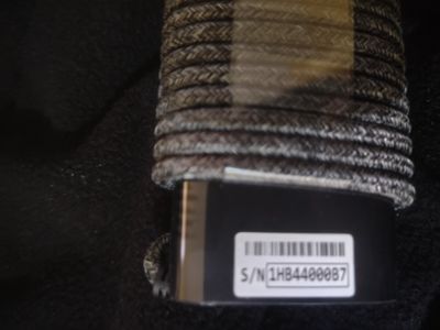

OEM HP Type-C  charger "frayed" and the plastic cover slipped-out of the base
No OEM plugs or batteries sold in local stores. So, I bought the iCreate

Yesterday. I gently cleaned the first USB Type C port, and the orange light flickered when I plugged my new HP 75w charger into the port.

Original HP OEM cord was and is frayed with white strings.
