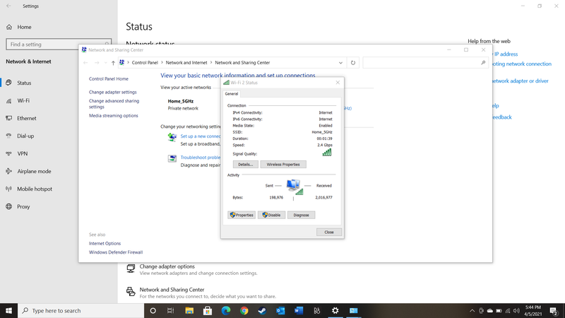

great! going to order an AX210 then, might as well fail big if it doesnt work, lol
