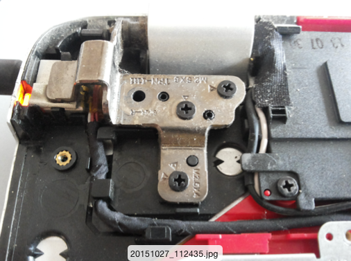

I finally Opened my laptop to try and fix the keyboard or get a replacement - It is then that I understood the nature of the problem.  The left and right hinges are designe differently. The right hinge has a screw farther into the latop. This I believe gives more support to the hinge and also the force directed towards this screw is not directly pulling it out.
Right Hinge
Looking at the left side, It seems HP knew that this hinge would be problematic. It is supported by more screws than the hinge on the right. What is alarming is that all the scres have pulled loose, destroying their sockets and pulling out the rings(?) that are supposed to hold them in place. One thing though is more alarming - one screw seems to not have been screwed in. I think this was a factory error because someone has reported it before. This screw just fell inside one of those rubber studs at the bottom of the laptop. as you can see, its socket is empty and undamaged. I have a feeling this misplaced screw, coupled with the fact that the left hinge pulls the screws directly out of their sockets on opening, leads to failure particularly of the left hinge. Left Hinge
I have re-attached the screw into the only intact socket, but i know it is no match for the force that pulled out the other four screws. I am going t try and use epoxy to attach the hinge to whatever surface contact I can get, but those sockets are pretty ruined for any sort of repairs.
