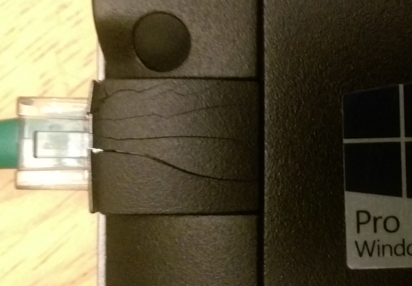

Reporting back in: I received a replacement laptop, same 840 G2, from my employer after the jack broke on the first one.
Just a few weeks later now and I used the jack perhaps 5 times or so and it is broken on this new laptop.
This is a junk design!
I took some pictures that show how that little flap is stretched/stressed when a plug is in it. How could that possibly last?
In our organisation have a lot of Elitebook 840 too and no such problem till now but 2 of 8 last received G3s have a broken jack just few days after purchasing. I think that quality of the jack depends from origin and some suppliers make bad quality parts. HP must revises its contracts but not to oblige customers to pay so much.
