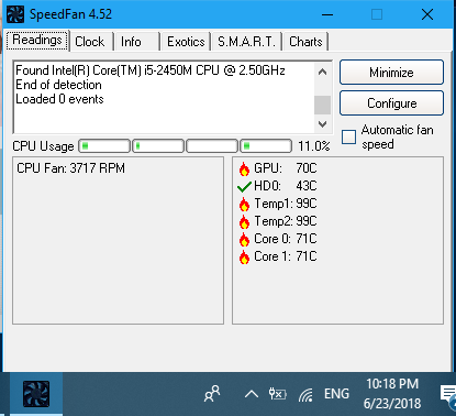

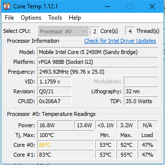

My laptop's temperature are very abnormal .
ScreenShot_20180615222017.pngThis is at no load
ScreenShot_20180615222140.pngThis is the tempearture when i OPEN youtube (no video running in background at all).
I just got it cleaned a week ago , applied the thermal paste again ,nothing blocking my vents , all cleared in my task manager.
Everything is perfect.
My laptop is cleaned and proceesor not clcoked .
while gaming (light gaming like counter strike source) the fps has huge drops like bormal its 60-70 and it drops to 20 in 5 seconds with large fan sound in that interval and then after 5 seconds all good again .
i checked my temperature using 3 different softwares and the result were all same .
it showed a 99 degree ceslius while the laptop wasn't even hot to touch like my other laptop .
The main problem is that the temperature are like 99 degress with no load and the fan louds itself up which is normal but after 5 seconds it drops to 55 degrees .I checked my task manager no programs running in background I even turned off Windows defenderbut same result.
I think  maybe the problem is in my hardware that identifies the tempearture and makes it look 99 degrees which in actual it isn't.
But i got it checked while dust cleaning and the results are all the same.
Please help.

The laptop's pretty old now and it was working fine before when I was using it in my college . After graduating I stopped using it for 2 months . I have been addressing the issue since then .
Laptop's model is dv4-5009TX
No i will run the hardware tests now and update you with the results.
The bios are already updated (last bios update was a long ago from HP though )
Updated my windows .
Got the laptop cleaned and changed thermal compound .
And yes I always open task manager when I switch on my laptop to terminate some startup programs.
Updated all my drivers using driver booster .
Actually can it be that the hardware that identifies the temperature might be faulty because the time when it shows a 99 degrees its still not hot to touch .(like my other pavilion g4).

Sorry for my late response , the results were completely normal . I also updated my Nvidia drivers but the problem was not solved still .

https://youtu.be/gHH0JC9BH-c
take a look here on the video i just made
ScreenShot_20180623221852.pngwell that suks i just updated my bios (there wasnt any update but still did it )
all drivers up to date
