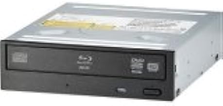

Here is the Service Manual:
See p. 46. You remove the back cover and one screw inside and the optical drive slides out.
This is the drive you need for the M7 models:
Blu-ray Disc ROM with SuperMulti DVD±R/RW Double-Layer Combo Drive 729728-001
This is a Blu-Ray reader which I gather is all you need as you want to watch Blu-Rays and not burn Blu-Rays.
You can buy the part as it came from the factory so it is just a slide-in replacement but very expensive:
Much cheaper to buy just the drive and swap the drive into the mounting bracket your current DVD drive is in. It is a 5 minute job involving maybe 5 or 6 screws.

The optical drive on most models is end user replaceable. I do not know your exact model because you did not provide it but on most of the Envys you just flip it over, there is one screw on the back labeled with a little optical disk icon. Remove that screw and the drive slides out. You can buy the HP replacement Blu-Ray disk module either Blu-Ray read or write and it is a slide in plug and play upgrade. Or if the actual HP part is too expensive you can buy a generic drive of the correct thickness and use the old DVD drive caddy and connector pieces to retrofit the generic bare drive into your machine.
The drives are generic. Any SATA BLu-Ray drive of the correct thickness with enough effort can be made to work on a laptop that uses a SATA DVD drive. Generic means industry standard, interchangeable.

Okay, I finally got the part that you recommended from eBay (it came from China). I unplugged the computer, shut it down, and removed the battery. Then I removed the little screw on back with the icon of a disc next to it. The drive came out easily. Now what? It looks like you would snap the outside ends off (the outside piece of the computer) But when I tried replacing the old with the new, it wouldn't stay. What am I doing wrong? Is that all there is to it? Once I can attach the end, just slide it back in place and replace the screw? Please advise.
