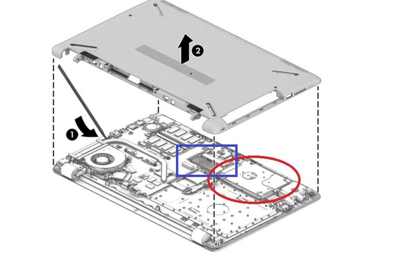

I want to upgrade my 15-bw028ca laptop by adding an SSD drive.
However, even after reviewing the hardware guide for 15-bw0XX laptops, it is not clear to me what are my options.  Basically, I need to know which option is available with this model.
(1) Keep the 1 TB HDD and add an SSD M.2 drive (then clone and reassign boot to the SSD).  It seems to me that there is a separate connector for this type of SSD drive?
(2) Replace the 1 TB HDD with a 2.5" SSD drive after purchasing the adaptor from HP.
I am assuming that option 2 IS available so my question is really whether I can just ADD an SSD M.2 drive to this laptop.  That would be the best option.
Can anyone clarify this?  Perhaps someone has already done such an upgrade for this model line?
This laptop very likely but not 100% certainly has an M.2 slot on the motherboard as shown here:
M.2 slot in purple rectangleM.2 slot in purple rectangle
Before you buy anything open the laptop and check for the presence of that slot. If there, it would accept a M.2 2280 form factor SATA (NOT NVME) SSD.

Many thanks for your response.   Yes, I will remove the back and have a look for the M.2 slot.  That would be the ideal solution for me to speed up the laptop's performance.
I will let you know how this goes.
Again, gracias for taking the time to respond.
Finally removed the backing to examine the motherboard.  Unfortunately, there is NOT an SSD socket.  The MB shows the pins where it could have been.
So my only alternative now is to purchase an SSD drive to replace the 1 TB 5400 RPM drive that came with the laptop.

You are lucky you asked here in the Forum as we are aware of this problem on this model series where the HP phone support, if you had managed to reach them, would have told you the M.2 slot was absolutely there because that's what the Manual says. Yes it would be a 2.5 inch SATA SSD. They are readily available and I have yet to find a bad one on the market. Samsung 860 or 870 Evo is "best in class" but you can buy on price. There is very little difference among them in performance.
