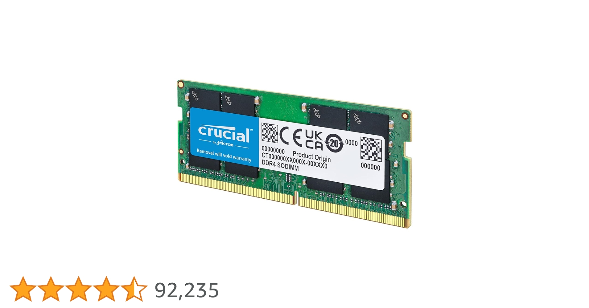

The laptop came with Micron MTA4ATF51264HZ-2G6E1 4 GB DDR4-2666 MHz RAM. I am planning to add another RAM stick - Crucial 8GB DDR4-2666 SODIMM.
Can anyone help and tell me whether these two RAMs will work together despite being of different brands, capacity and CAS latency?
Any help is much appreciated.

Hi:
You should be fine.
Not only that, but Crucial is a division of Micron, so the memory is probably the same.
See if you can get this part number in India...100% compatible with your notebook according to the Crucial report.
https://www.crucial.com/memory/eol_ddr4/ct8g4sfs8266/ct14006772

Amazon.In still has the one from the link I posted that is 100% compatible...
https://www.amazon.in/Crucial-CT8G4SFS8266-Unbuffered-SODIMM-Retail/dp/B071KNKBQ1/ref=sr_1_2?dchild=...
If the link is giving you a DDR4-3200 chip that they say is compatible, that should work fine too.
Yes, Amazon still has it. But as you can see, it is also displaying that a newer model is available for the same item.
And when I check the newer item, I got to know it is the same model number which Crucial said is the replacement for the older model. So should I buy the newer model or the older one? I'm sceptical of buying the older one as it has reached EOL.

Hi:
Either one will work just fine.
The old one will bridge to 2133 MHz, and the newer model will also bridge to 2133 MHz.
EOL means that Crucial isn't going to manufacture the 2400 MHz chips anymore, just like you don't see any 2133 MHz chips anymore.
