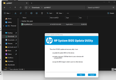

What I did discover is that if you extract the  softpaq with WINRAR  and then run the Insydeflash.exe on a different Windows 11 PC, you do get options.
See the image below. All you should need is to make a recovery USB flash drive and boot the laptop to it.
