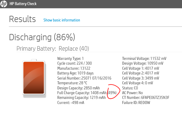

The battery on my HP Notebook 15 Laptop dies anywhere around 60%-50% without any warning. I'm not sure if the battery icon is indicating the correct battery life. Just a couple weeks ago, it was fine. The laptop itself is several years old, and it still has the stock battery (which is a removable stick thing).
After researching a bit, I believe the problem is that my battery is only charging about halfway, then stops. The battery icon indicator incorrectly displays the battery left at 100%. In other words, my battery only charges up to halfway, but my computer is telling me that it is fully charged.
It is a similar problem to the one this person linked below had, but the BIOS settings HP Support recommended to download in the link aren't for my computer. I went to the HP Support Assistant app to update my computer with any drivers it detected I needed, one of which being a BIOS update, but the problem is still occuring.
https://support.hp.com/us-en/document/c02467292

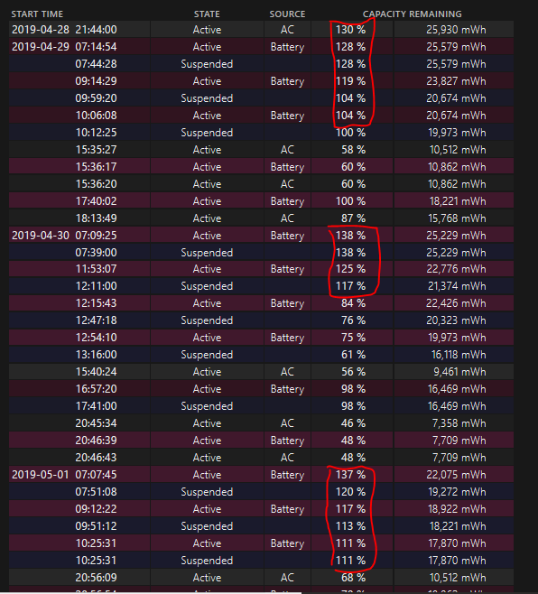

What doesn't make sense to me is why my computer is displaying an incorrect percentage of the life left on my battery. I attatched some pictures of a cmd-generated battery report and an HP Support Assistant battery troubleshooter.
My guess is that I just need a new battery (which is no problem) but I want to double-check.
Thanks,
-Shane
Circled in red are the battery percentages that seem abnormal...
Here it seems to me that the report is telling me that my battery is holding around half of the power it used to.

05-01-2019 09:26 PM
Hi:
It sounds to me like your notebook's battery has one or more bad cells.
What happens is the notebook runs fine to a point, but when it gets to the bad cell, it just shuts off w/o warning.
The first thing to do is to look at the battery troubleshooting steps at the link below.
https://support.hp.com/bg-en/document/c04700771
If they don't resolve the problem, you will probably have to replace the battery.
