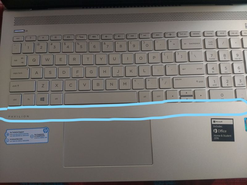

1- My usage of laptop is very low and I use simple application still I am getting low battery backup
2-Where is the battery located in the hp cc129tx as I know its non removable but in which section it is located
3- In the right and left side of mousepad I am feeling that some part is extending is that mean battery is expanding inner side..?
@Jainesh
You are very welcome.
You are out of options.
"Fat" battery must be replaced.
It won't get better and it most certainly could get worse.
Battery location:
Part Number and Replacement Procedure - Page 39
Open document:  Maintenance and Service Guide
If the battery is bloated, swollen, extended  >> there is no other fix except to replace the battery.
Use does not matter, age does not matter.
The battery will fail - likely sooner rather than later.
From the previous post:
Important
  1. If the battery is bloated, swollen, or expanding beyond its normal size, there is no fix except to remove and replace the battery.
  2. A bloated battery can damage other components in the notebook, including the case, the keyboard (individual or all keys), the TouchPad, and any component that is stressed due to the expanding battery.
Good Luck.
Stay Safe.

How can i verify that my battery is swollen or expanding cause my warranty period is over and I am also attaching two pictures only the part above the touch pad is slightly heavy and its very slightly so i dont know weather it is normal or not..?
@Jainesh
Were it me, and I needed to know the condition of the inside - I would take apart the computer and look at it.
If I can think of anything else useful to add, I will edit this message.
