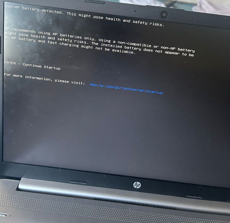

Recently I am getting a battery error which says that I am using non HP battery and my laptop shuts down immediately if it is not connected to charger. I haven't made any changes to my laptop or battery and I am using original HP charger.
Is there any way to fix this error or do I need to replace the battery?error.jpg

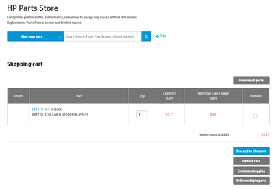

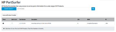

  • Purchase a genuine HP replacement battery to avoid compatibility issues:
Order link: https://partsurfer.hp.com/?searchtext=L11119-855.
Also check out my response to a fellow HP 15s-fq1002na User: https://h30434.www3.hp.com/t5/Notebook-Software-and-How-To-Questions/weak-battery-HP-Notebook-15s-fq.... A quality, affordable non-HP battery replacement option via Amazon-UK: https://www.amazon.co.uk/HT03XL-L11119-855-15-CS0053CL-15-DA0014DX-HSTNN-UB7J-battery/dp/B0B7JH78XN/....

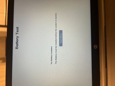

Thank you very much for your help. I tried to verify Battery’s condition using HP Diagnostics and it says ‘No Battery Installed The Battery must be installed before the system is started’
Also, when I turn on the laptop I get this message
 followed by the non-hp battery detected message
I also did bios update but it hasn’t helped yet.
@dubub,
Thank you for the pictures!
The battery alert almost certainly indicates that your battery is defective. I would replace it with a quality generic battery as I referenced via Amazon-UK.  Given the quality of today's replacement batteries, one can safely ignore HP's warnings about the evils of non-HP batteries.
