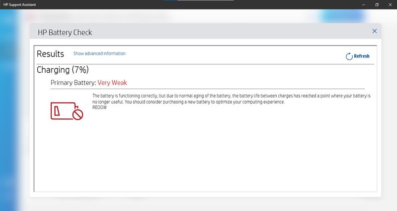

Hello! My battery died a few days ago (the battery test says it's failed, I get battery 601 alert on startup, when I turn on laptop the battery is on 0% and won't charge..). So I suppose there's nothing else I can do than replacing it. I'm still using the laptop having it plugged in while working since it turns off immediately, I haven't tried to remove the battery. I wanted to ask if there's a specific battery I should get, since the search results while trying to find the right battery for my laptop were rather poor. Thanks for any help.  Could you provide me the correct battery code?

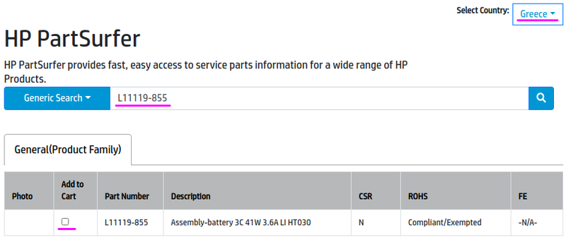

Hello @panos171717
(1) Battery
HP spare part number: L11119-855
Assembly-battery 3C 41W 3.6A LI HT030
(2) Where to buy ?
HP Partsurfer:
https://partsurfer.hp.com/partsurfer?searchtext=L11119-855
or
Search on aftermarket ( ebay, aliexpress, amazon,  ... ) and catch genuine or compatible part.
Please pay attention to HP spare part number and specification.
(3) How to replace battery ?
Download --->>> Maintenance and Service Guide
Page 41 Component replacement procedures
Kind regards

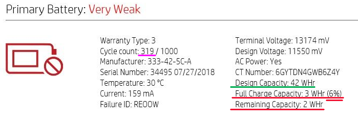

The baterry's reports are attached below.
Thank y0Battery Report 2.jpgBattery Report.jpgou very much

(1) Click <Show advanced information>
(2) Send screenshot of advanced information
Kind regards
Hello @panos171717
Thanks for reporting.
(1) Analysis
Full Charge Capacity: 3 WHr (6%)
Remaining Capacity: 2 WHr
The battery already has a few charging cycles, but it has lost a lot of capacity overall, so it needs to be replaced.

Hello @panos171717
(1) Battery
(2) Where to buy ?
HP Partsurfer:
or
Kind regards
