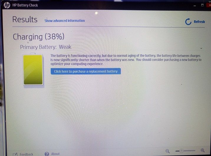

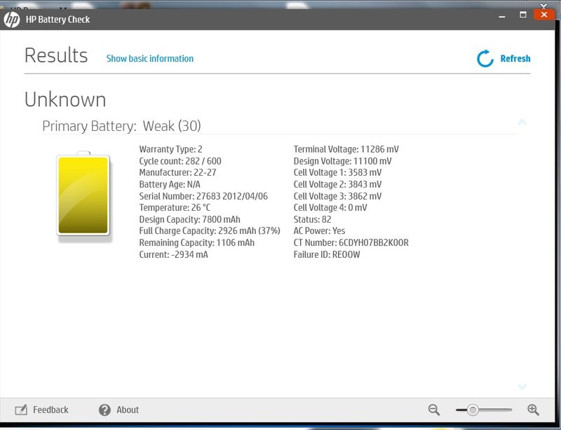

10-03-2017 09:46 AM
I tryed other wall outlet and I am always using surge protected plug. I also tryed without surge protected plug. Batery is fixed. I checked temperature of battery. it was normal. Battery is not listed on battery recall program. Is it secure to use always charging battery?
10-03-2017 10:44 AM
Thank you for replying with this detailed response 😉
I appreciate your time and efforts,
It's okay to use the battery always connected to the outlet as the smart adapters sent along with HP products auto-stop the charge once it reaches the required charge, hence ensuring the battery isn't damaged due to over-charge.
That said, if the PC shuts down as soon as the adapter is disconnected from the wall outlet, there could be an issue with the battery and I suggest you run a battery test: Click here for instructions.

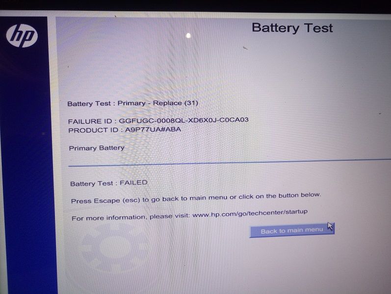

10-03-2017 02:56 PM
Thank you for responding,
It's great to have you back 😉
I'm afraid the battery test failure confirms a hardware malfunction within the battery and I recommend you Contact HP to have the battery either repaired or replaced:

10-09-2017 10:29 AM
I understand and agree with you, although, you could get a battery replacement done locally,
or on your own, just find the right part using the HP Parts Surfer and order it either on the HP Parts Store or the local online retailer.
