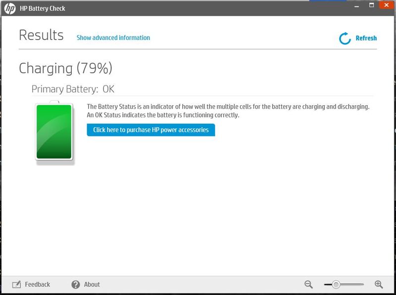

After about a year my battery will no longer charge past about 80%.  The battery is integrated into the machine and I cannot remove it.  Please assist.
8 REPLIES 8

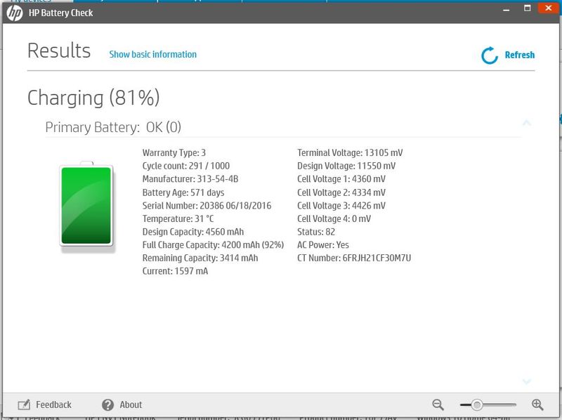

It can be removed but we will get to that later. First you need to test it. 2 ways to do that. 1. IN UEFI diagnostics (tap esc as you power up then F2 and look for battery test; or, 2. In HP Support Assistant. Look for your device, troubleshooting and battery test. Run it and get to the advanced results and please post all the advanced results or a screenshot.
Thanks. The battery is not sick so we have some kind of other problem going on.
