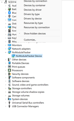

If there is a working fingerprint sensor installed, the Device Manager will detect it.
Control Panel > icon view > Device Manager
Tab View
Check Show hidden devices
Select Devices by Type
Expand Category (for example Biometric Devices)
Right-Click on the Driver > Select / open Properties
Tab Driver
Compare Driver version to the driver listed in system's support page Category Software and Drivers
Example - Device Manager - Biometrics and IR Camera
Device_Manager_Biometrics_Camera_1Device_Manager_Biometrics_Camera_1
