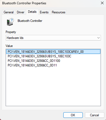

Here are the hardware IDs:
OK, there's the problem.
That is the Ralink Bluetooth adapter blocking the installation of the Broadcom Bluetooth adapter.
Right click on that device and select uUninstall.
Also check the uninstall driver box, restart the PC and see if Windows installs the Broadcom Bluetooth adapter.
