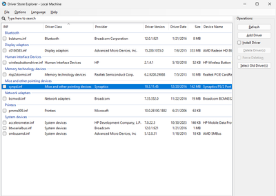

I also downloaded and installed a program called Driver Store Explorer to see what's going on with the driver, and this is what it showed:
So it seems that the driver has been installed but the program shows that the driver file doesn't have a device name associated with it. I also right clicked the file and clicked on Open file folder location, and I saw a bunch of hex files for bcm4350 and bcm4356, but nothing for bcm4352. Maybe you gave me the wrong driver?

Do you think disabling Secure Boot in the BIOS will solve the issue? I also downloaded and installed a program called Driver Store Explorer to see what's going on with the driver, and this is what it showed:
So it seems that the driver has been installed but the program shows that the driver file doesn't have a device name associated with it. I also right clicked the Bluetooth file and clicked on Open file folder location, and I saw a bunch of hex files for bcm4350 and bcm4356, but nothing for bcm4352. Maybe it's the wrong driver I installed?
