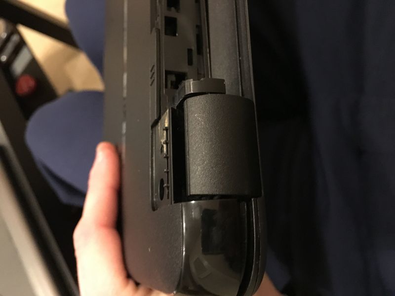

I finally got a chance to remove the bottom cover. The plastic screw anchor mount for the top fan screw (between the fan and hinge) has broken. The shiny gold anchor piece has fallen out of the black broken plastic, leaving that screw almost ineffective. Also, there is another broken plastic screw anchor mount on that hinge. That screw is also now ineffective. So it appears 2 plastic screw anchor mounts have broken and black plastic pieces were moving around.
When I put my computer back together, there is bulging around the power button/left hinge.
How did these plastic pieces break? I have never opened the computer and I am extremely careful anytime I handle my laptop. It mainly just sits on my desk!
Is there any way to have this fixed? I’ve included some photos
