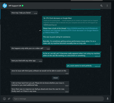

Thanks for pointing me in this direction. I am afraid it was a dead end. I was advised by the website that I need to make use of the WhatsApp chat functionality, and I did so. See the below chat log:
I was not really interested in engaging further with them after such a flippant dismissal of my query.
