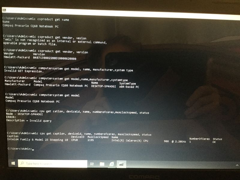

We used the crucial websites tool to determine easy upgrades. It came back with a model number on CQ60z series. After some searching I was confused about the CPU. When I could find CQ60z info it did point to an AMD but the sticker on the front said Intel. I ran wmic commands in the command prompt and this is what I got:
As you can see it definitely has the Intel processor and the Presario CQ60.  I’ll take a look at the manuals you linked and the T3400. Thank again.
