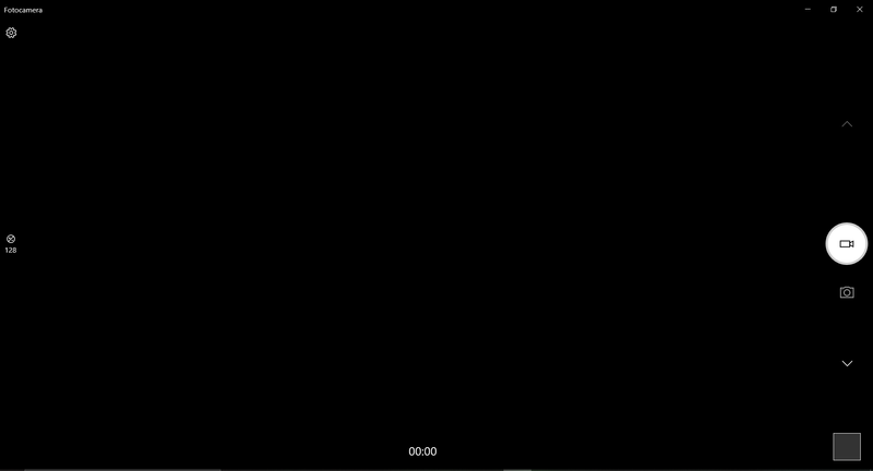

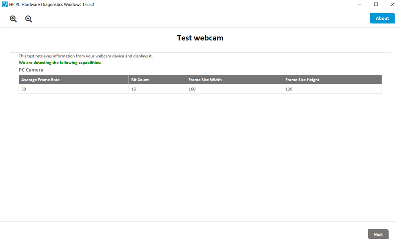

Hi, recently the integrated camera of my notebook started to have some problems, first sometimes I happened to see some lines or artifacts in the image, then during a videoconferencing it suddenly stopped to work and the other person couldn't see me, but after restarting the computer the cam was fine. Now, after some days, I tried to open the camera app but it seems like it doesn't catch light, it's all black. I tried to restart the pc but it didn't bring back the camera, I tried to run the hp diagnostics, but except it detects the wrong resolution everything seems fine, i even tried to search for driver updates but there wasn't. I'm afraid I have to bring the notebook to the assistance to solve the problem, but I would like to know if there is a simpler solution. Sorry for my poor english
