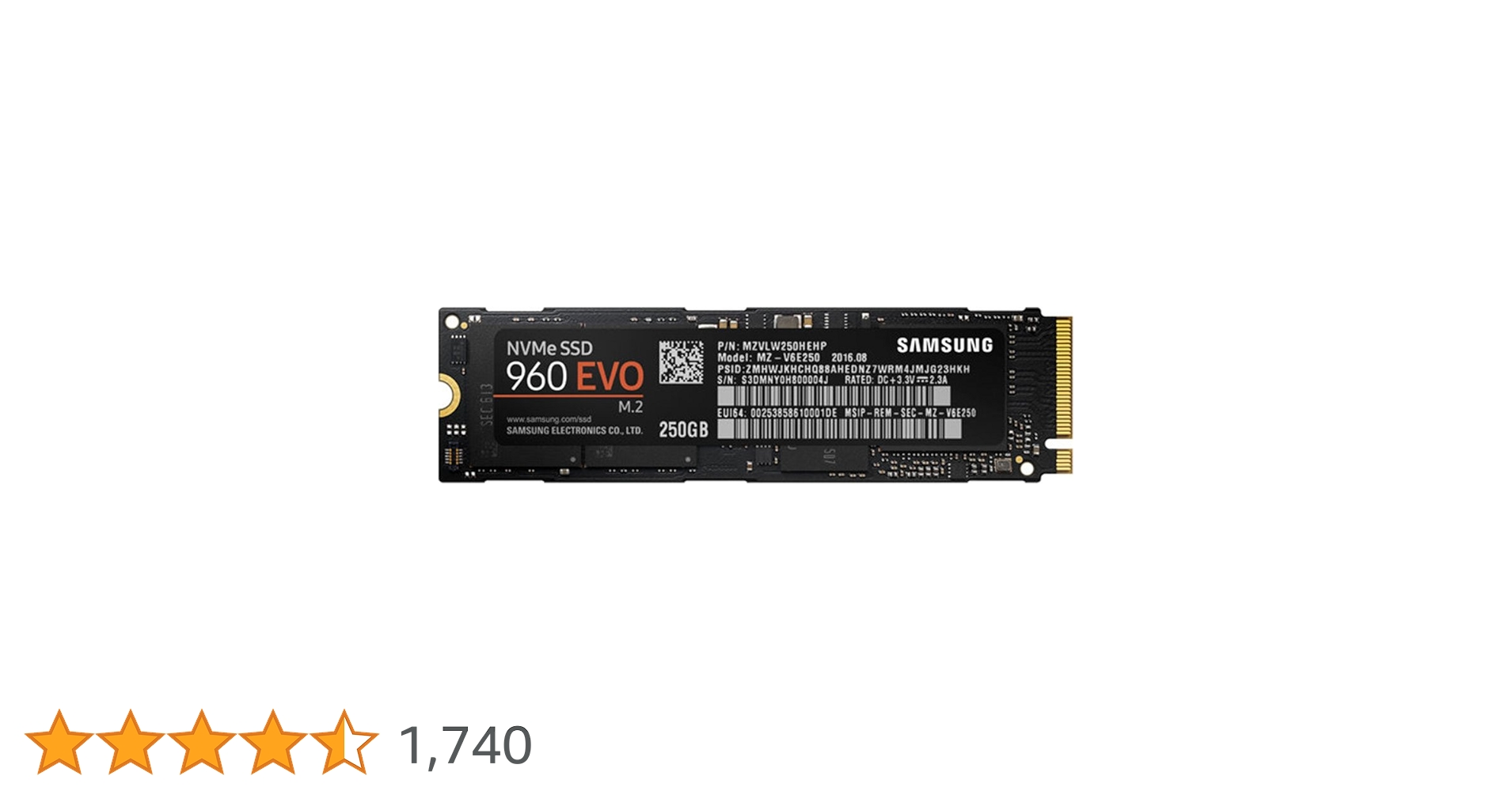

Do you think I can purchase Samsung 960 EVO 250GB
No see where it says it is a PCIe/NVME. I was specifically warning you not to buy that kind. You have to get a SATA-3. Samsung Evo 850 M.2 or WD Blue M.2 are good examples.
