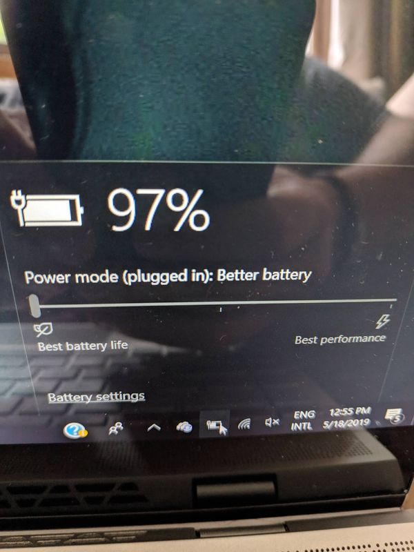

I disagree with this outcome, my wife owns the Macbook 12 inch retina... and i tried the charger for that to charge my ENVY 13.
it is currently charging and seems to be fine... I travel for work and am planning on using a Macbook Charger to charge my Envy 13, my Ipad Pro 11 and my Android phone.
The adaptor is a USBC 29W charger for Macbook 12 Retina...while i have been typing this... the charge has gone from 89 - 95 percent charged
05-18-2019 12:09 PM - edited 05-18-2019 12:10 PM
That is not a mystery. Your model is designed for USB-C charging so there is no basis for disagreement. HP offers a 65w USB-C charger for your model. USB-C charging works on your model but won't work on the model that this thread is actually about.
So thanks. Nice pictures.
