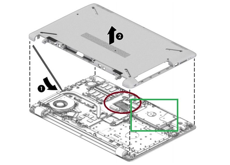

Open it up and you see this:
red circle = M.2 slotred circle = M.2 slot
Open it up before you make any purchase of upgrade parts. In some cases this slot was not actually soldered onto the motherboard at the factory.
