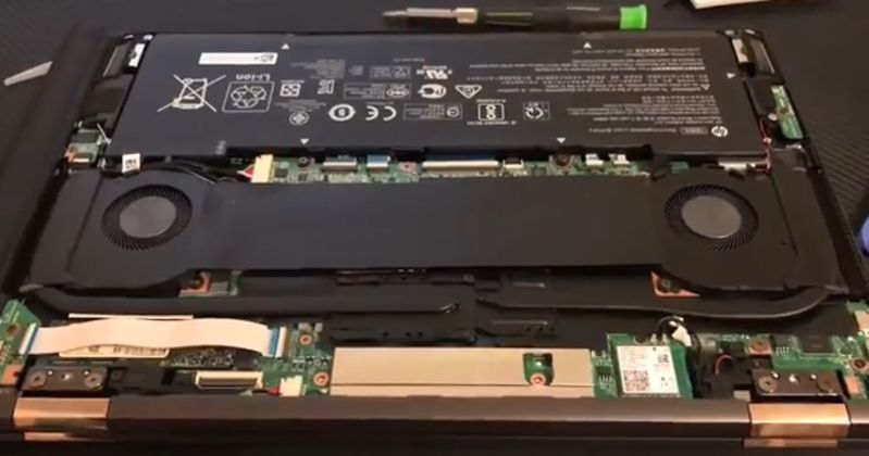

I have solved the annoying click/pop noise upon applying pressure to the front corners! This involves clear scotch tape and a torx screwdriver, and isn't dangerous or difficult. First, take off the back plate by taking care of those torx screws. Then apply clear scotch tape around both front corners (those opposite the hing side) of the plate you removed. This provides damping against the literal metal-on-metal popping/scraping (there is no rubber or any kind of protective material between the chassis and the removable bottom plate, which explains why so many x360s have this issue). Then just screw the plate back in and voila. I know, I know, the tape looks a tad weird but you could probably trim it off and it's on the bottom of the laptop so it's not too big of a deal. The satisfaction of not having constant popping noises while resting your hands on the chassis is well worth it.

Hi Nstommel,
Thanks for your helpful post. I opened up the back of the laptop. Could you please point out the place where you put the scotch tape on the below picture? I tried couple places but didn't work.
Thanks again.
