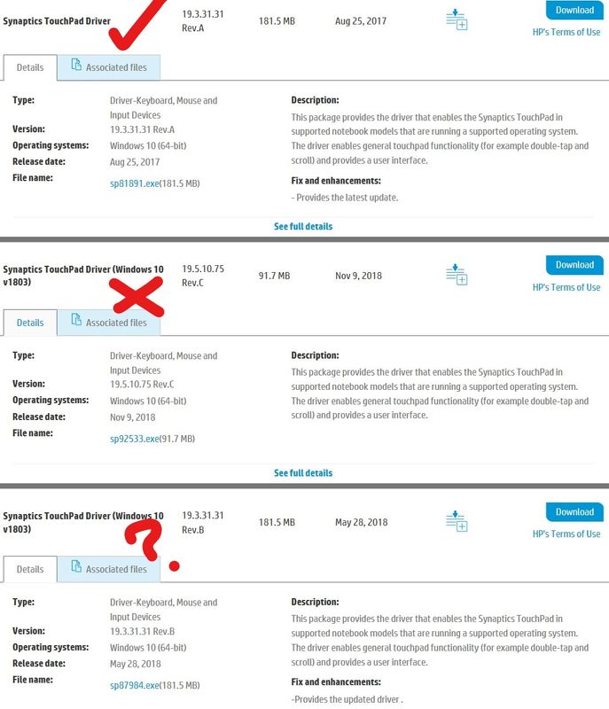

Yeah so I tried with another operating system to see if the touchpad has a hardware issue.
Everything works great, the clickpad is recognised and the buttons work.
I returned to Windows and tried to troubleshoot again. Turns out the HP Assistant failed to install the driver and I downloaded the wrong one from their website (very tricky to understand wich one to use). I downloaded the one below (an older version from the looks of it), uninstalled the current driver, restarted, installed the newly downloaded driver and restarted again 😪
Good old synaptics driverGood old synaptics driver
It worked. In case someone else is wondering this is the right one to use.
There are 3 drivers available!!There are 3 drivers available!!
HP should remove useless or buggy drivers. One might see a higher version number for the same driver name and think that's the right one to choose.
