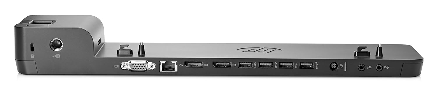

Do you know which version of the HP Ultraslim Docking station  you have?    There were some specific changes in regards to the 2013 generation of the dock where the docking station has 2 x DisplayPorts instead of earlier versions that only had one DisplayPort and one VGA.
If you have the later 2013 Generation docking station and have 2 x DisplayPorts,   those monitors should be fine.  And you'd of course need the two displayport cables to use with the monitors (monitors might come with them, but make very sure they do).
The 2013 Model looks like this (2 Display ports to the right of the Network jack):
