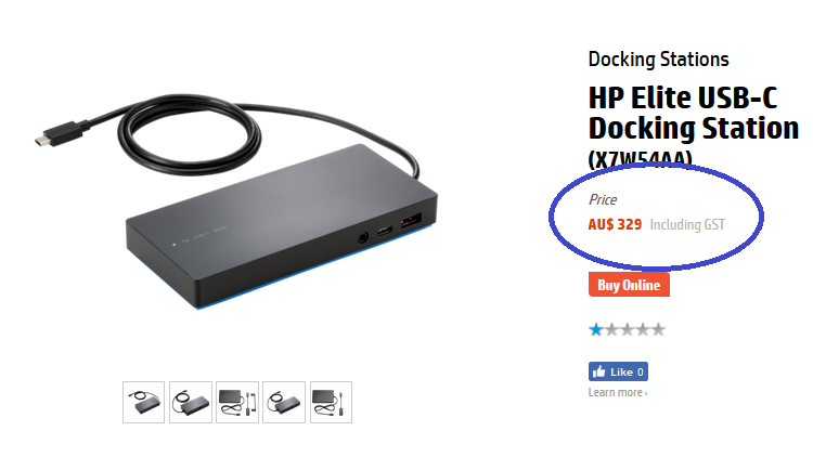

Side note: From your image, the dock price is US$149.00 + tax (says 7.5%) = around AU$210 but HP in Australia sells for AU$329
Amazing ! AU$100 more for HP Australia for a same product. May be HP has to ship the product from China to the US first then send first class air to Australia.

The website indicates it suports multiple
The Model is X7W54AA#ABA
here is a screenshot
