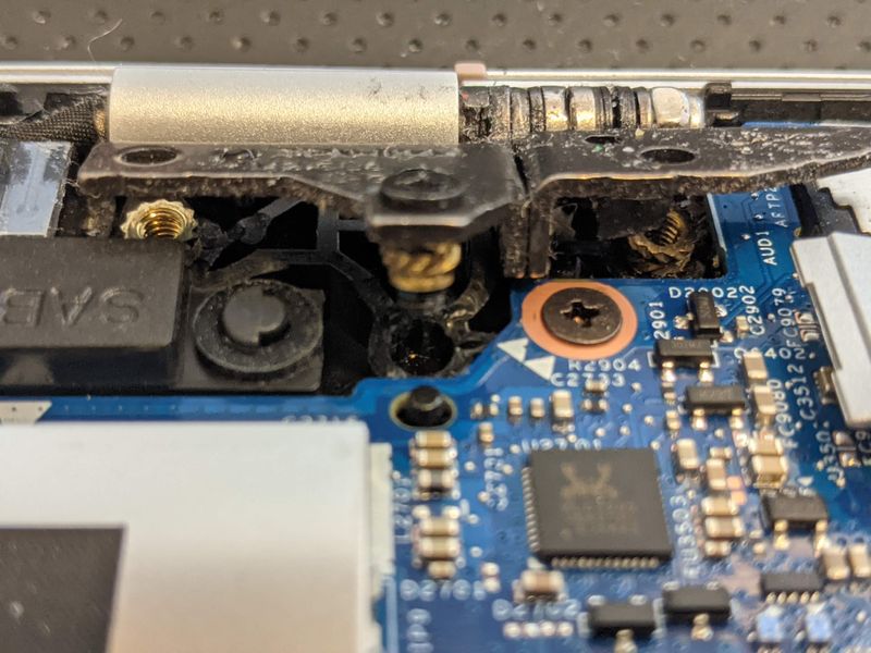

HP ENVY - 13-aq0011ms - 6 monhts out of warranty and my hinges can no longer attach to the Laptop base. The plastic for the thread inserts broke off so the hinge plates can no longer screw into the base. My laptop was in perfect condition.  No drops or bumps. Light use. So careful with the lid. Based on the way it failed, I can't help but think this is a manufacturing defect. You would think there would be more support for the threaded inserts. Is there a way to fix this or or am I left with a defective laptop?
You can see the exposed thread inserts due to plastic disintegratingYou can see the exposed thread inserts due to plastic disintegratingHappened to both sidesHappened to both sidesAll the broken plastic pieces I had to take out.All the broken plastic pieces I had to take out.There was nothing for the thread inserts to hold onto.There was nothing for the thread inserts to hold onto.

Its not defective plastic its a seized up hinge. It would pull the locking screws up out of metal. I can discuss DIY options if you wish but almost nobody wants to go there. I have also escalated your issue to see if HP can offer some help. Good luck and post back if you have questions.
That makes sense in a way. But how did the hinge seize up? Was it over torqued from the factory? I'm interested in DIY options but would rather if HP could either provide me a new base enclosure that I can transfer the parts into.
Hinges just seize up with use. It's common in thin laptops. HP is not the only affected brand. I am a fellow end user; I can't arrange to send replacement parts and HP likely no longer stocks the parts you need for sale. Yes, you need a new base enclosure and new hinges, too.
