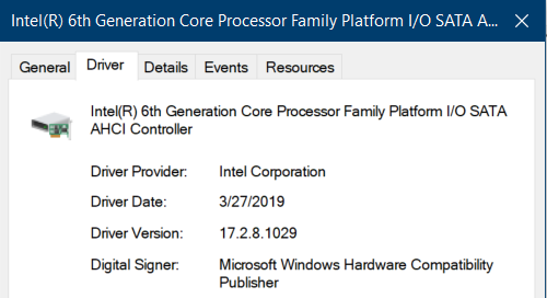

Hello. My question is regarding the drivers for my SSD. Some info:
  • HP Pavilion Laptop 15-cs0059nr (from bottom of device)
  • Product Number: 4EY55UA#ABA
  • Windows 10 Pro 64-bit Version: 18362.418
  • Bitlocker full-disk encryption activated
  • recently updated BIOS firmware (F.19)
  • recently updated chipset driver (Intel(R) 6th Generation Core Processor Family Platform I/O SATA AHCI Controller. 17.2.8.1029)
  • Possibly relevant info from Device Manager
    • Device Manager / Disk drives / SK hynix BC501 ...(long string of letters and numbers)
    • Device Manager / Storage Controllers / Microsoft Storage Spaces Controller
    • Device Manager / Storage Controllers / Standard NVM Express Controller
    • Device Manager / IDE ATA/ATAPI controllers /
      • Intel(R) 6th Generation Core Processor Family Platform I/O SATA AHCI Controller
Recently, an update for Intel Rapid Storage Technology appeared in my HP Support Assistant. I downloaded it and installed it. Nothing strange happened during the install, but afterwords Intel RST was nowhere to be found on my PC (now that I mention it, I don't think it was installed before the download either). I thought it might have something to do with outdated firmware or chipset drivers on my PC so I updated both of those. Then, I tried installing Intel RST from the HP drivers site for my laptop. I was able to install it, but the only interface it connected with was an empty SATA port (I think my laptop's SSD is NVMe). The HP drivers page had a few different versions of the Intel RST drivers. I tried all of them with Kaby Lake in the title but got the same outcome.
I just want to make sure I'm not missing out on faster speeds from my SSD because something failed to install. I appreciate any help you can give. Thanks!

OK, so that driver is not going to have any effect on the NVME controller your notebook has.
It's interesting they have a RST driver that is supposed to work for NVME drives, yet it does nothing and has no support for the hardware ID your notebooks NVME controller has.
Accordingly, the RST driver is something you really don't need, since your notebook does not have a SATA hard drive.
But it does have the SATA controllers, so you may as well be up to date.
As far as the chipset driver, if it was the wrong one, the "Intel(R) 6th Generation Core Processor Family Platform I/O SATA AHCI Controller device would not report as working normally.
Anyhow, you can install a newer chipset driver for notebooks with the 8th gen processors from the link below...
10.1.18019.8144      Aug 26, 2019
https://ftp.hp.com/pub/softpaq/sp99001-99500/sp99031.exe

I wonder if you could help me with one more thing that sprang up as I was updating my BIOS and chipset drivers. I got the drivers from the official HP drivers page for my laptop:
https://support.hp.com/us-en/drivers/selfservice/hp-pavilion-15-cs0000-laptop-pc/20284004/model/2232...
I downloaded and installed this driver because it appeared to be the most recent version for Kaby Lake CPUs:
https://support.hp.com/us-en/drivers/selfservice/swdetails/hp-pavilion-15-cs0000-laptop-pc/20284004/...
However, the has drivers for laptops with several different configurations (for instance, there is a driver listed to prevent write-head crashing on HDDs, even though I don't have one).
Looking in my device manager, I can see a device listed as:"Intel(R) 6th Generation Core Processor Family Platform I/O SATA AHCI Controller". However, my CPU is an eight-gen i7-8550U. Is it possible that I accidentally installed the wrong chipset driver? Probably I'm just freaking out over nothing. Thanks again.

You're very welcome.
